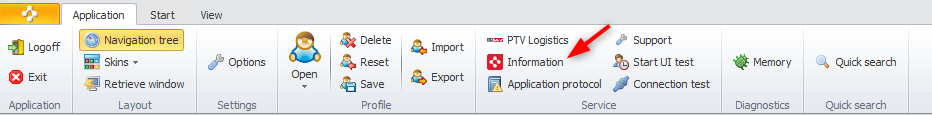

1) Start PTV Route Optimiser ST , click in the "Application ribbon" the "Information" button.

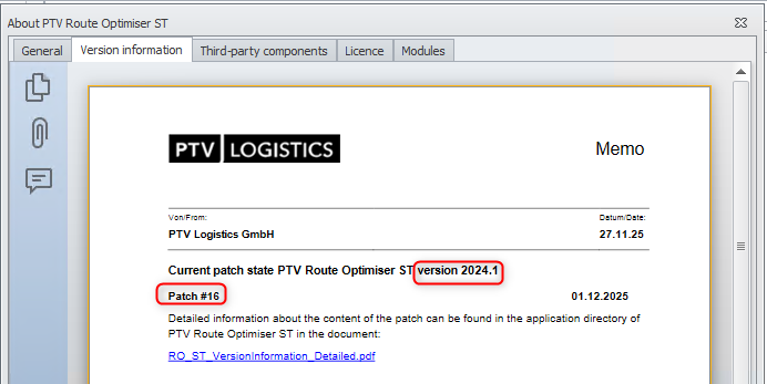

In the 2nd Tab: "Version information" you will find the Program version and the patch number:
