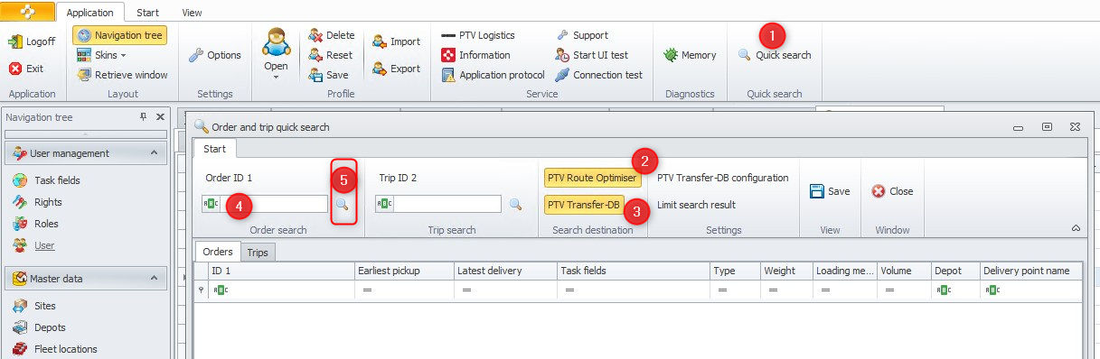

For that question you can use the "Quick search" within PTV Route Optimiser ST.
So the steps are:
(1) open Quick search dialogue
(2) mark the "PTV Route Optimiser ST" button so it is yellow, for checking the RO-ST database.
(3) mark the "PTV Transfer-DB" button so it is yellow, for checking the Transfer-database as well.
(4) enter the Order-Ext-ID ( ID1)

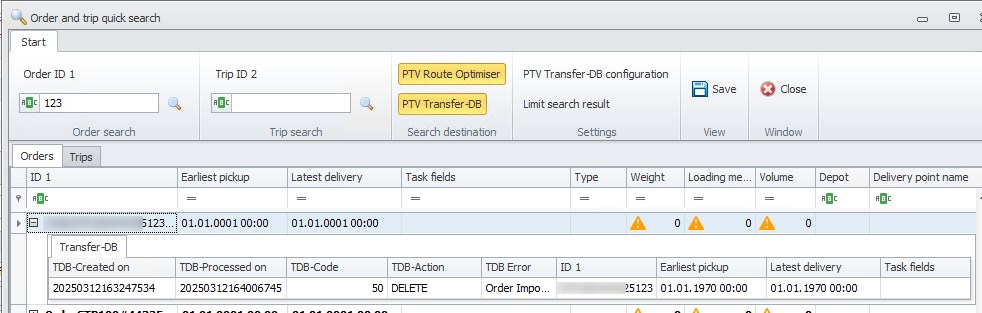

If the order is shown in the Orders-Tab, the order was imported.
In addition, if you are using a transfer database, you can view information (3) from it alongside the order by expanding the row with the plus sign to the left of the “ID1” field:
