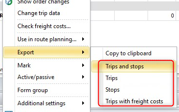

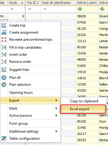

I want to use data from the Trip planning outside of PTV Route Optimiser ST. How can I export orders or trips?
Answer
You can export data from a table grid by using the grid-context menu.
"Export / Excel export"
When exporting trips, you can also distinguish between trips, stops, or freight costs.
The export is done into an Excel document. ( .xlsx )
