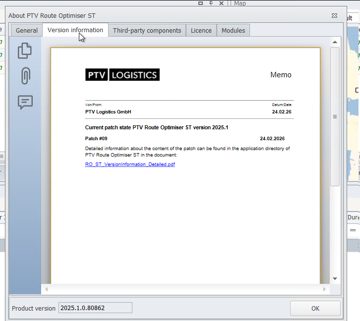

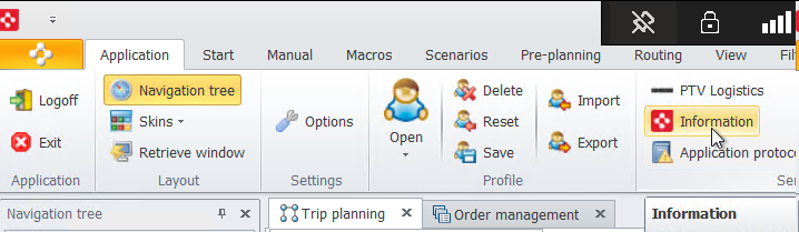

Version Number and Patch Number
To access this information, click the "Information" button:
A window will open. Go to the "Version information" tab:
You see the Version number (2025.1) and the patch number (Patch #09).

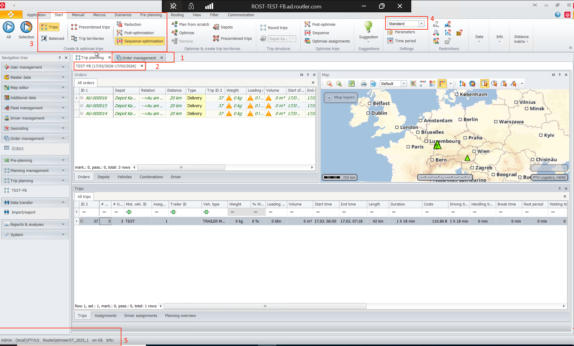

Screenshot
A screenshot can say more than a thousand words. For PTV Route Optimiser, we need a screenshot of the entire application.
Example:We gain much information from such a screenshot, not just about your problem.
- We see which module you are using
- If in the planning area, we identify the selected planning area and chosen time frame.
- We see your settings about planning.
- We see which parameter-set was used
- We obtain general information such as the active PTV Route Optimiser user and the database used.

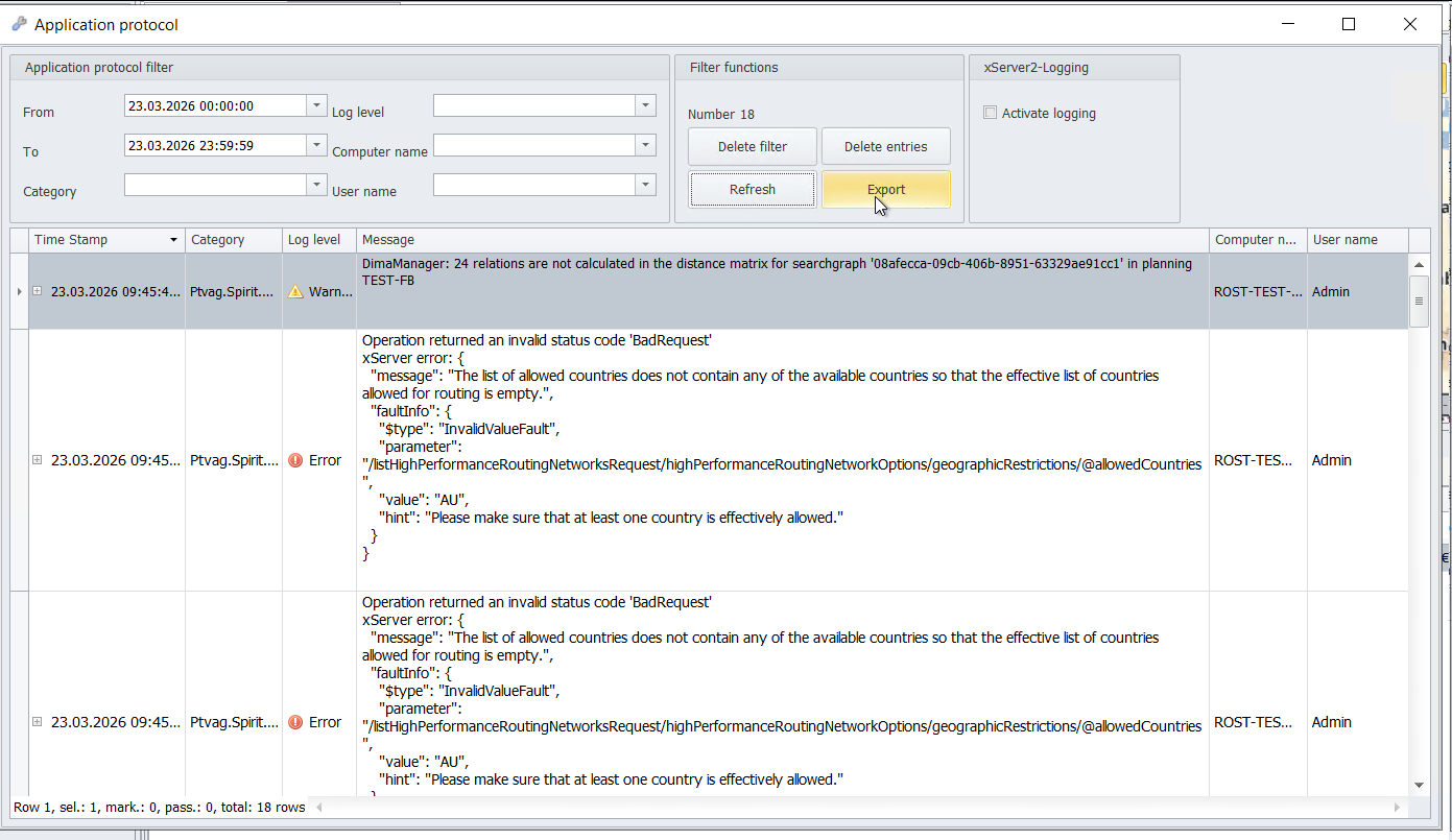

If you get an error, expand the detail window before taking a screenshot or copy the error message. Alternatively, export the application protocol.

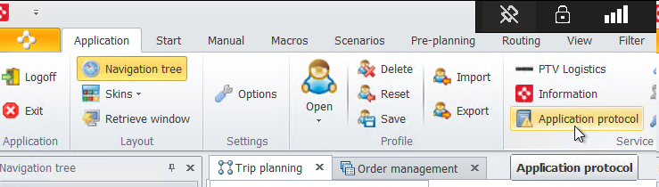

Application Protocol
You can export the application protocol:
Open the Application protocol.
Set the FROM/TO date to one day. Click Export. The log will be saved as an XML file, which you can easily email to us.
