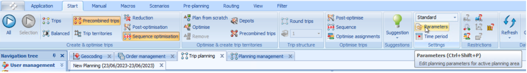

Here we have two different use cases. You can change parameters in the planning by using the button “Parameters”.
These changes are temporary and only apply while the planning is open. Closing and restarting will erase all changes.

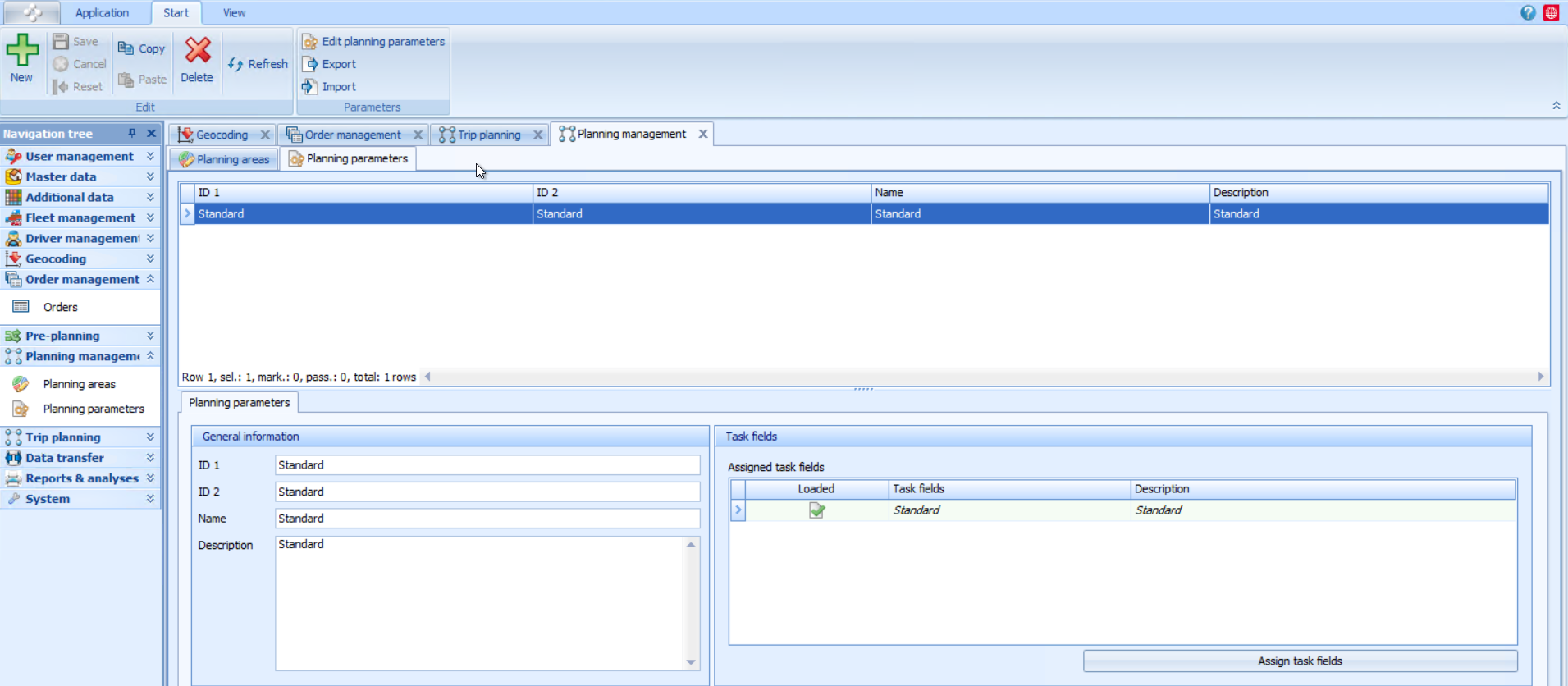

To make permanent changes, go to “Planning management,” edit an existing parameter set, and save it.
Note: For changes to affect an open planning, you must close and restart it.
