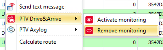

Step 2 – If a route has already been sent with the "Hauler" checkbox enabled, remove monitoring from Axylog first.
Step 3 – Ensure the route is sent in the standard format (without the "Hauler" flag selected).
Step 4 – Re-send the route to Axylog.
“Activate monitoring” via context menu.
