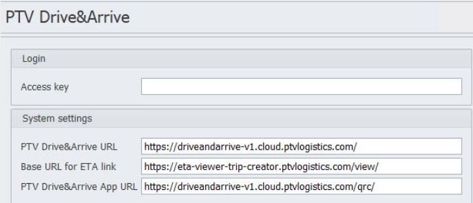

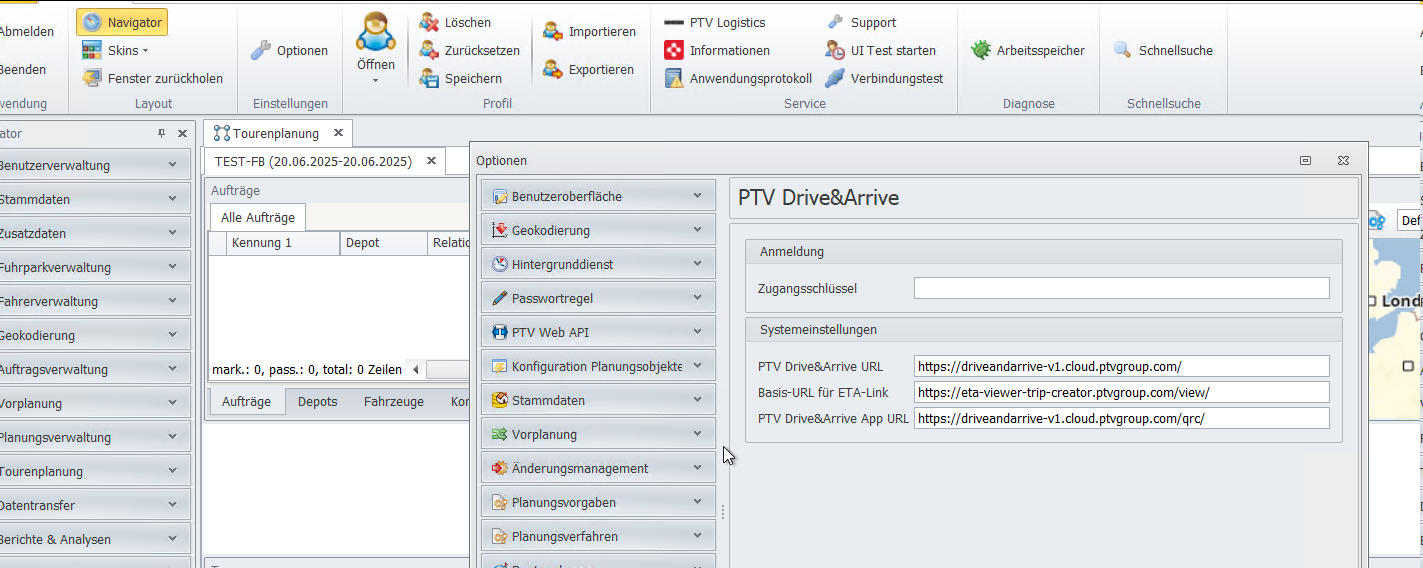

To fix this, it is necessary to login as system user in PTV Route Optimiser.
Change those settings in global options:
New values are:
https://driveandarrive-v1.cloud.ptvlogistics.com/
