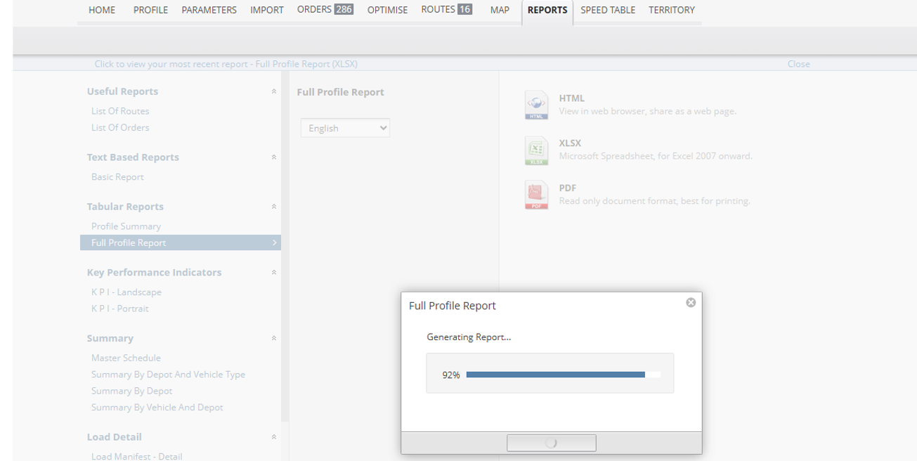

Symptom
A Full report becomes stuck while loading (as shown below)

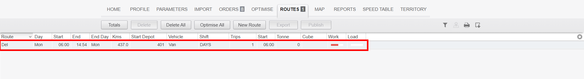

Example:
The route below is named "Del"

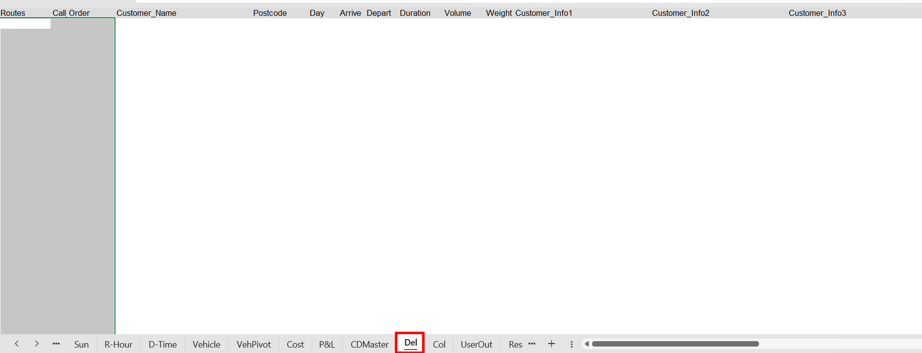

However "Del" is also the name of a worksheet within the Full Report (as shown below)
When a route name matches one of the predefined worksheet names used by the Full Report, a naming collision occurs. As a result, the report may crash or become stuck during loading.
