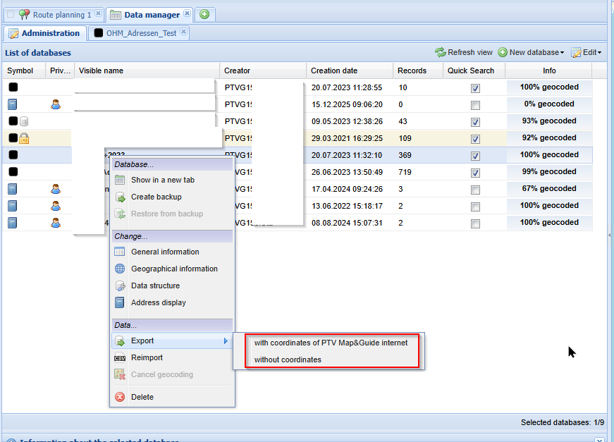

- Data from the Datamanager:
Please export your data from the datamanager in the old PTV Map and Guide internet

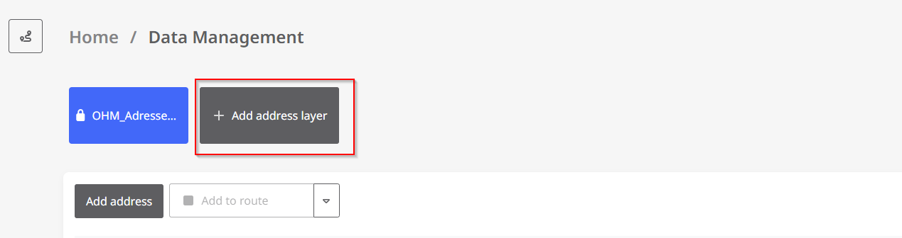

Please open the "Data management" in the new PTV Map and Guide and select "+ Add address layer"
Add your exported data opening this or using drag & drop.
