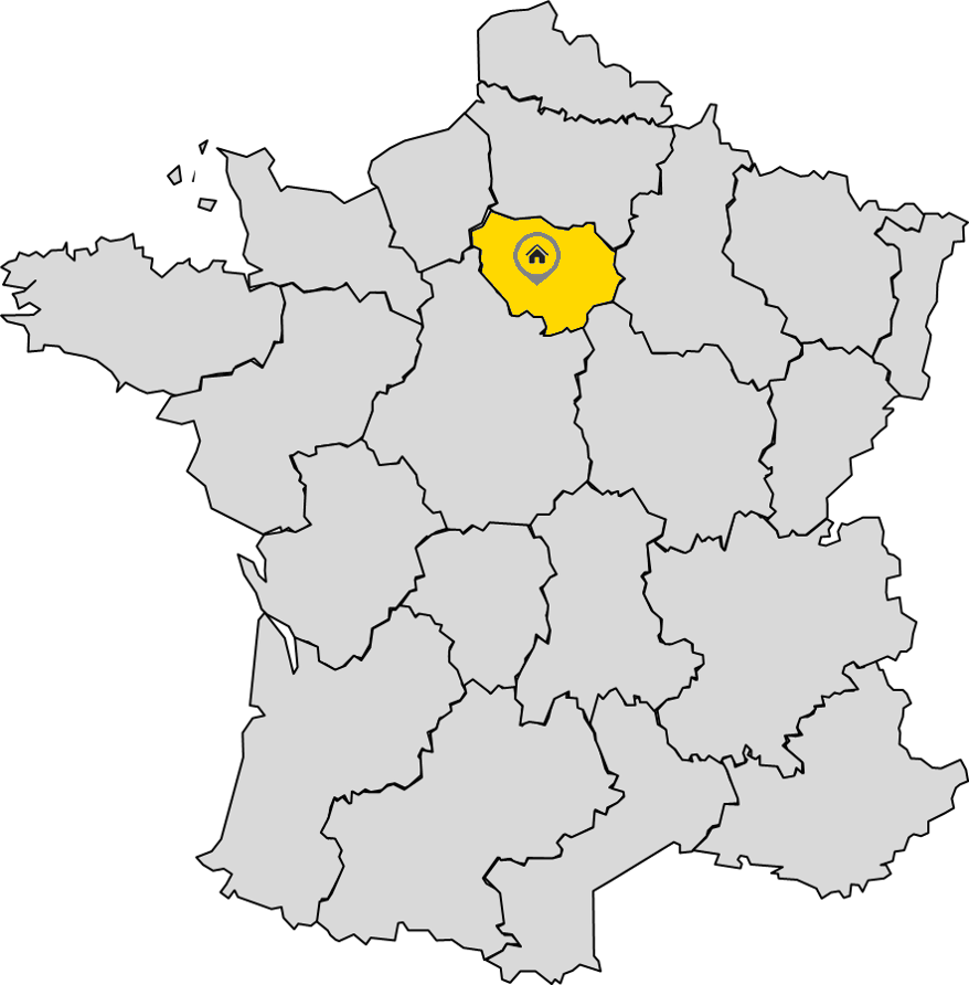

Reaching the lower end of the 5–20 MB/h range depends on having maps downloaded in advance over WiFi. If a country hasn't been downloaded beforehand, PTV Navigator G2 builds up its local map memory on the fly, region by region, which uses more data:
On app launch — the region around the current GPS location downloads automatically. These are always 100 MB map blocks.

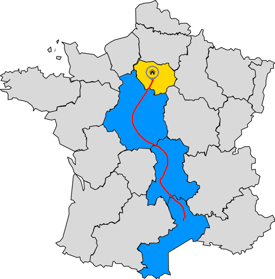

On route planning — once a route is calculated and navigation starts, the regions the route passes through also download. These blocks are also 100 MB each.
If a driver later drives through a region that's already been downloaded, it isn't downloaded again — the map data is reused from local storage for display, while traffic and the route (if there's a connection) still come from the server. Map data is updated regularly by TomTom; if a route passes through an already-downloaded region where an update is available, only the changes are downloaded, not the full 100 MB block again.
