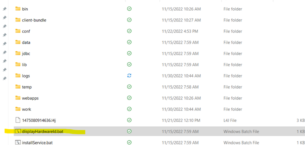

Follow these steps on the server where xServer 2 is installed:
Open the xServer 2 installation directory.
Double-click the file
displayHardwareId.bat.A text file named
LocalHardwareID.txtwill be generated automatically.Open the file and copy the alphanumeric HardwareID.
Send this HardwareID to us so that we can generate your xServer 2 license key.

A screenshot is attached for reference :
